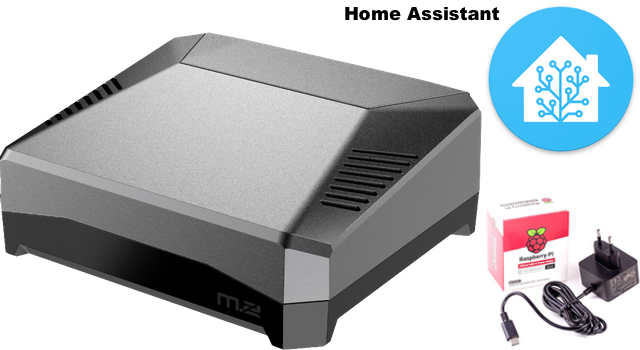

I completed inventory and ordered my alternative.
Plus SkyConnect for zigbee and a second hand ICS-1000 for kaku/coco - which was the only thing not directly found as supported.
Listed all my stuff and wishes, documented where to find the integrations and to my surprise found that it actually works with more out of the box than Homey.
MHI duct Airco, Panasonic Aquarea heat pump, dashboards out of the box.
Also filed return request with supplier (not Athom) on the basis of Dutch law article 7:17 stating it does not conform to what has been advertised and can reasonably be expected. (Zigbee issue, everything local is a lie)

The situation is absolutely fantastic!
Yes, some things require careful reading instructions and checking some stuff. But anyone who already did a cloud integration with API keys and such for Homey (anything beyond the very basic) will easily get things set up quickly.
The Home Assistant box from above came completely preconfigured with essential tools and zigbee dongle installed. It took me one day in between work to set up the devices, today to customize dashboards.
Standard dashboards are already great.
But just putting a map of your house and overlaying devices onto a dashboard, I could manage with some basic example Python code without prior experience.
Lights with sensors don’t need anything complicated. Out of the box it understands an area should be quiet for x time in order to turn off lights again.
Many devices autodetected on the network. All devices are SOOOO much more responsive. All zigbee super stable, with more end devices.
Cameras, Presence and security automation took less than an hour.
The only challenge has been kaku/coco - there are ways for which I got some 3nd hand hardware for 433Mhz. But after seeing how easy all this goes without that tech, I already ordered Zigbee shutter controllers to replace the Kaku ASUN650s for under 30 euro.
