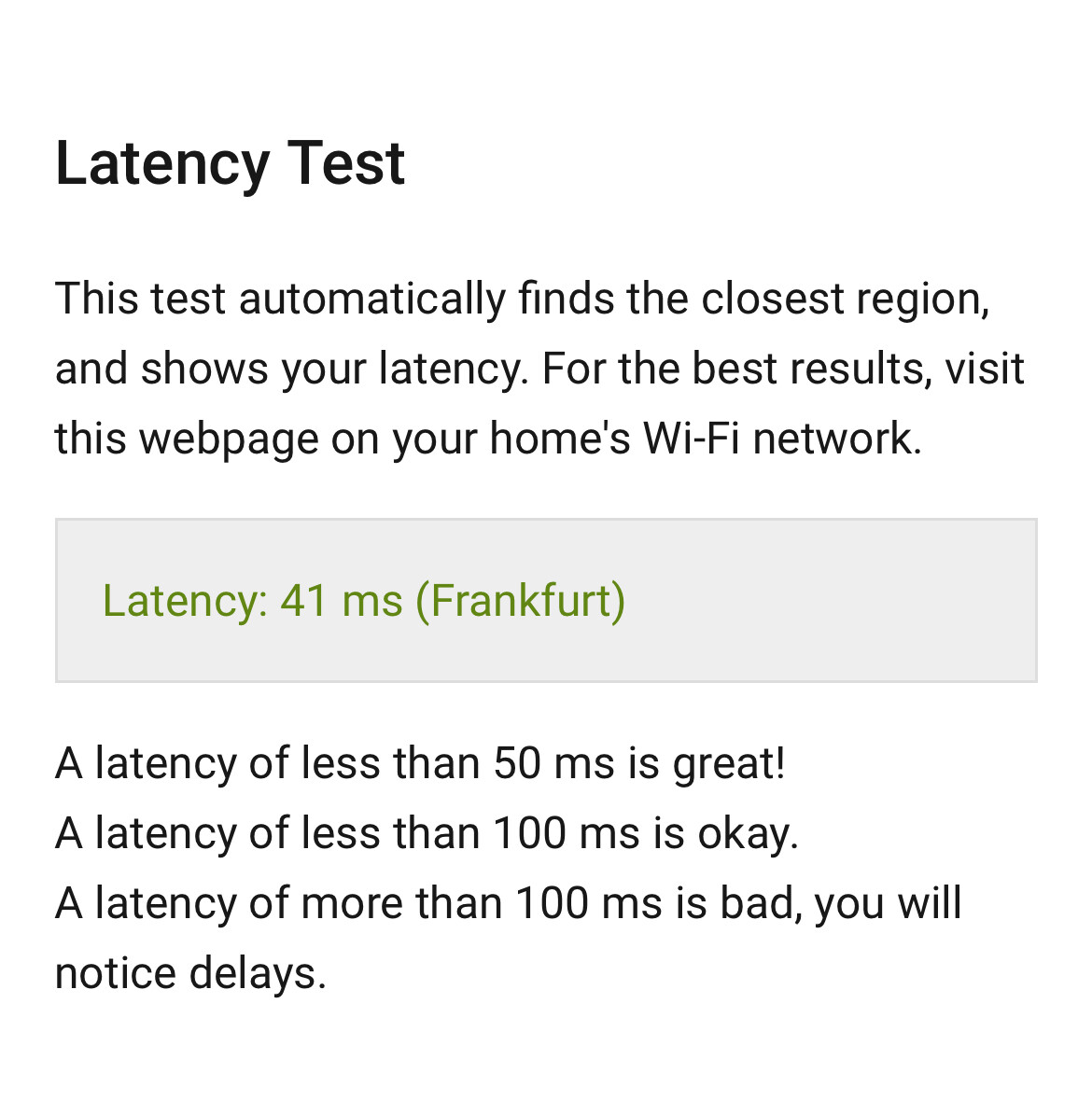

Hi, as I am a Homey Bridge / Homey Cloud user like you, I would like to know if your system still works as nicely as you describe, during the last week or so. My own setup worked reasonably well up till last week. Now it failes to start virtually all of the time based flows, about half of the webhook based flows, plus many flows based on device events. When I do webhook calls, I see latencies up to 600 msec (Frankfurt server). I have submitted a support request, but Athom will need 3 weeks to respond.
i have no issues, flows work, webhooks fire and receive, zwave,kaku,zigbee work
i am also on frankfurt.
few weeks ago i had also some issues with auto flows, but a restart of the bridge fixed it.
net latency gemeten
