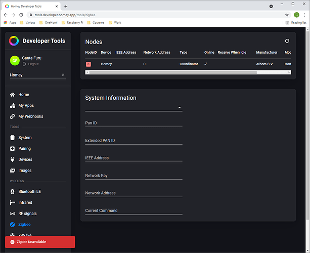

https://tools.developer.homey.app/tools/zigbee
Good tip, found it, but it tells me ZigbeeUnavailable
That doesn’t show the mesh, though, just some (random?) routes.

Did you find a solution to this @Rodge? I get the same “Zigbee Unavailable” error message on Homey Bridge. It is a very strange behaviour - if I restart the device the [Zigbee] tab under [Tools] works as expected for 3s which is just enough to show that it connects to my devices. After those initial 3 seconds have passed I get “Zigbee Unavailable”
I tried using a different power supply (2.4A) but same story

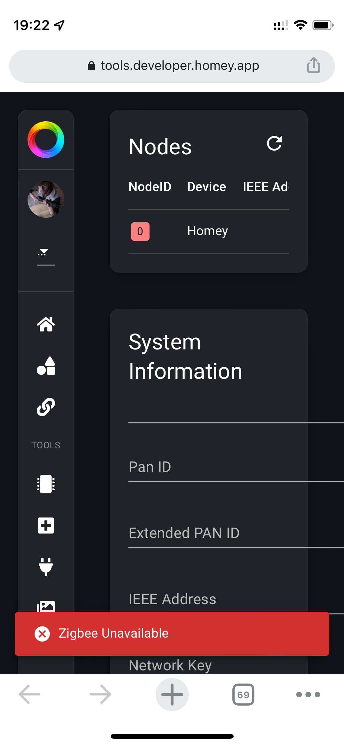

Hi, have this problem now.
Everything worked fine until this afternoon. Tried restarting Homey Bridge and router several times but did not help.
Reported it to Homey. Perhaps any tips what to try?

I’m afraid there is a hardware issue with the Zigbee chip in the Bridge.
On the developer site, It does not show any Zigbee nodes. And also reports “Zigbee unavailable”.
My 433 and infrared devices work just fine, through the Bridge.
That sounds like a hardware issue, yes. So you’ll have to wait for Athom to respond.
