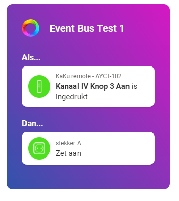

From made some flows using the example on the app’ app store page.
(Kanaal = Channel
Knop = Button / knob)
I hope it makes some more sense
Lovely Peter, it does make sense, thank you.

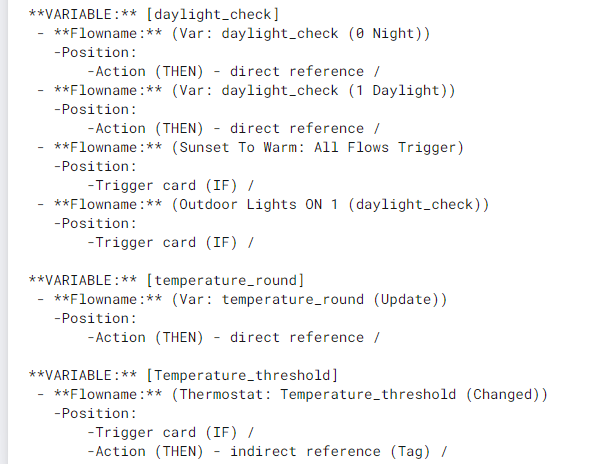

Well, to locate the variables, u can use this script I posted here in the meantime:
Output example:
W O W! This one is cool. I’ve seen it in the thread, but thought somehow you rewrote the FlowChecker for your personal use (what do I know?), didn’t realize it was a HomeyScript.

It works! And it’s so great tool! Thank you very much for sharing it!
I especially like having both direct and indirect refs. Great job

I’ve noticed one, strange thing, though.
And I can’t really help with solving it in any way. But the daylight_check variable from the picture above is probably one of the most used variables in my flows, and it doesn’t show there for some reason…
For instance, there is no: Kitchen: Light ON 1 flow in the list.
So, I guess, be cautious when depending on the script when changing variables, because there might be some more flows using them.
That’s odd.
This is a var I use in the biggest number of flows, and all of them are listed…
