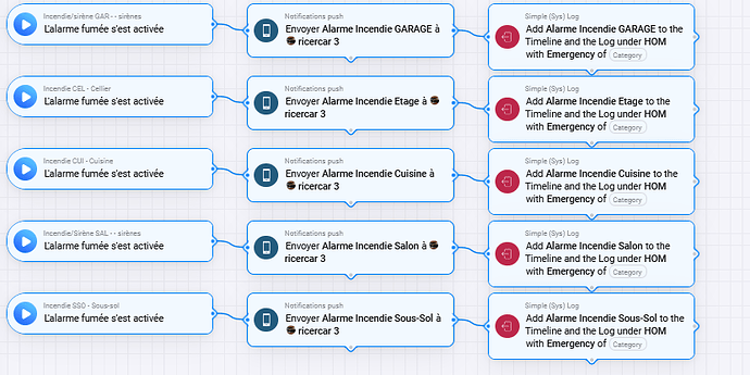

Show your flow(s).
2 Z-Wave pop smoke + 1 Honewell Zigbee + 2 Heiman (1Z-Wave+1Zigbee)
Capture d'écran 2024-07-07 132925
Correction : the Z-Wave detector triggers the alarm. It’s the Zigbee one which doesn’t (as shown in the timeline after I smoked it after adding it again)
