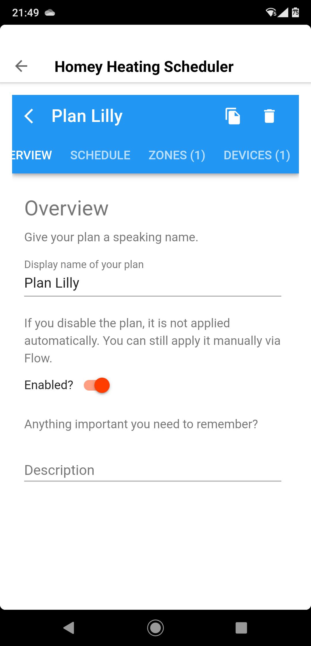

Is the VThermo listed as device inside the heating plan?
Have you activated the zone or single devices inside the plan?
Yes the VThermo is listed inside the plan. Actually I have activated both the zone and the device (VThermo) inside the plan.
