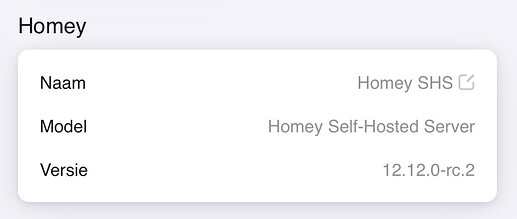

Menwhile there is a v12.12.0-rc.2 vor SHS available on Athom’s Github:
Which I was able to update to by Portainer:
Using the latest-tag still doesn’t work, you have to tag the exact version like above.

I will try to explain. The tags latest and stable are still on 12.11.0 there briefly was an 12.11.1 beta after which we decided that it was confusing because all betas for pro are 12.x.x-rc.x so it became 12.12.0-rc.1. The changelog for 12.11.1 should have never been in the stable changelog and I since have removed it. 12.12.0 will become stable soon.
I now see that Camera Streaming marketing was done so I understand the confusion and frustration. I will move 12.12.0 to stable now.
