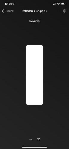

I saw your post already in the group thread. The reason why I didn’t answered was that I don’t understand the problem correctly.
Because I don’t have no problems to group 2 Fibaro RS2, and the dim slider is available:
The previously paired roller shutter switches look like in the picture from you.
The newly paired roller shutters, the settings, the configurations and the functionalities are the same:

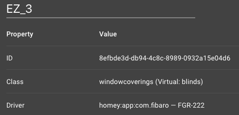

I compared the device classes on the developer page and i saw this difference:
Devices, which can be grouped under “Dim Level” in the “group” APP, have the class “windowcoverings”:
Screen Shot 2021-05-24 at 21.11.58
Devices, which cannot be inserted, have the class “windowcoverings (Virtual: blinds)”:
Screen Shot 2021-05-24 at 21.12.34
is it possible to change the device class from “windowcoverings (Virtual: blinds)” into only"windowcoverings"?
All my blinds are listed as „windowcoverings (Virtual: blinds)“ in Developer and I can group them:
Maybe yours can’t be grouped because they have different classes.
