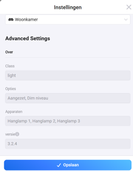

old topic but I am in trouble with this app. I have two groups. In both of these groups one device (a lamp) is ignored. Ok I must admit I had a power break yesterday so the homey had a sudden power loss but after the restart everything seemed to work ok, except for the groups. I have deleted one of the groups and tried to rebuild it. Without succes. I have three bulbs I want to group, In the group app I can add these bulbs and they appear in the settings. However I get no response from hanglamp 1. If I try to repair I see that hanglamp 1 is not checked in the repair screen, but there are three devices selected and that is strange because there are only two devices checked.
does anyone know what is going on here? BTW I have the same issue in another group with only 2 lamps
Ah. Problem seems to be solved by restarting the app.
