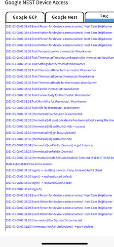

Last week I added two nest cams, google hub max and doorbell. Today installed thermostat (learning v3). Unfortunately I cannot add the thermostat. When adding the thermostat It is not found. Logged out and back in but this did not solve the issue. Any ideas?
Hi Paul, how many devices do you have, 4 or more than 4?
I have in total 5 devices. 2 cams, 1 max, 1 doorbel and 1 thermostat.
Found this morning the reason for not being able to add the thermostat. Did log out but forgotten to enable the thermostat when I logged in. Overlooked that setting. Changed the slider and added the thermostat worked fine.
Thanks for the update… Was worried that even 5 devices in some instances would not be detected…
