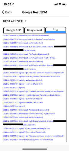

I have one problem. In the native Nest app on my iPhone I see all eight (8) thermostats (plus my three Nest protect boxes). And when authorizing in the Google Nest tab and logging in to my Google account in step 2 I see all eight (8) thermostats including one named ‘Study’. I click Next and login to my account, Advanced, ‘Go to athom.com (unsafe)’ and click Allow, then I get the banner ‘You can now close this window’. All good so far.
However when I look in the log I see ‘login() -> got 7 devices, command needed to complete Auth’, and when try and add a device the list of thermostats returned are just seven (7) devices as ‘Study’ isn’t included :frowning:
Any idea why the full list of all eight (8) thermostats isn’t being retrieved from the API and returned to the app?

any errors in the log? anything particular with study thermostat (type or something else), the interface is picky…

Here’s the logs. All looks fine apart from 7 of 8 thermostats returned from the API call. There’s nothing unusual about that missing thermostat, it’s running the same software as the rest and is visible and can be controlled from the Nest iOS native app.
I’m wondering if there is a tool or something I can use to manually make the API call with the same credentials to see what the Google API is returning, or if there is any error with that. Any ideas?
Not easy to just do that call outside the app. I will do some research and check back with you.
Thanks.
One small suggestion. Perhaps on the log tab add a switch to enable verbose logging, so more detailed log entries are written by your app. Not sure which log tool you’re using (Winston, Bunyan?) but adding log.trace or log.debug log event writes would help when trying to isolate problems like this, even writing the raw JSON that is returned from the API to the log file.
