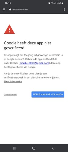

op gevanceerd klikken en dan door naar athom.com
You are doing nothing wrong, the generated app (your own project) isn’t verified by Google. You are essentially sharing your information with yourself. So just click advanced (Geavanceerd) en continue!
