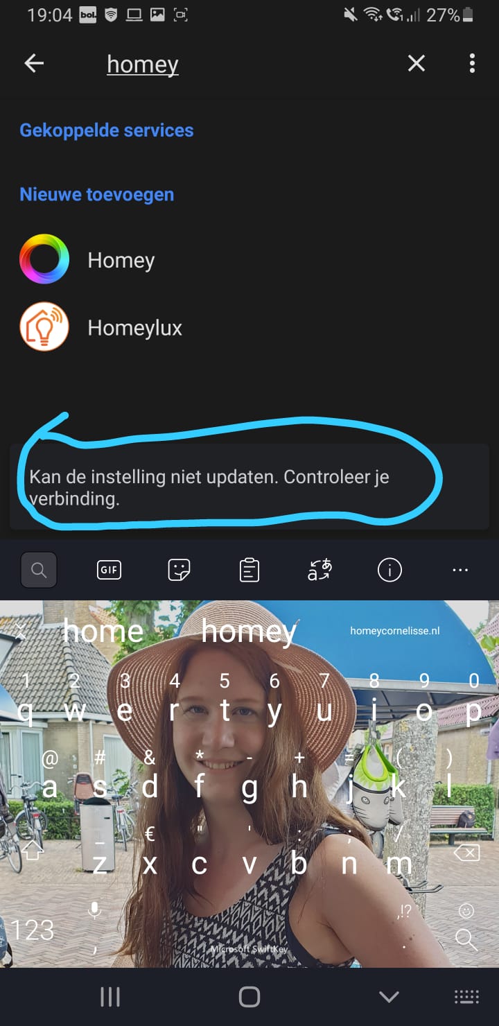

Hey all,
Today, i wanted an old device to be out of google home, and i was stupid to disconnect and try to reconnect as i could just have used the synchronize button. Anyway, now i cant reconnect.
Homey says it cant update and i have to check my connection.
I also tried to connect a different way, and over there it says its connected, but whey i try to play the sound, its says: * pling* homey doesnt respond at this moment, try again later.
When i
I tried a 20 minute reset.
I tried to do it with the homey settings > google assistent
I tried a 2.4ghz connection. Nothing works.
Could anybody please help?
I got the same problem, see Google Home integration blocked.
Where your first screenshot come from?

Upgraded to V5. Lost connection
Thought i could remove and reconnect. just errors

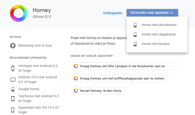

Its from the first post in here:
