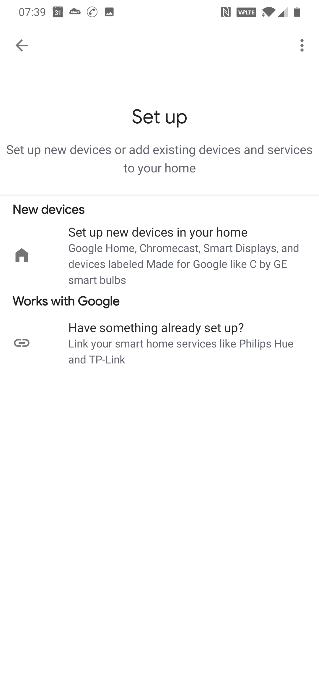

My linking isn’t working.
Doing the steps , adding honey but I come back to setup device screens and the honey is not in the connected apps in Google home.
Is there any faq for this?
So I start here and end up here :

Just take a look at the pic again.
Woops, now i see it. :flushed::blush:
