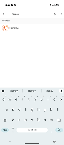

Hello, I’m following this discussion because more or less I have had all the problems you have listed, but everything was working fine until yesterday.
Following a series of “There has been a problem…” On Google Home side, I have tried to delete Homey from the list of apps working in Google Home, but to my surprise, it’s not there anymore! I mean, Honey was not in the list!
I have then tried to add it back, but homey is not in the list of the “Works with Google” apps (picture attached)..
Someone else with some ideas or in my situation?
