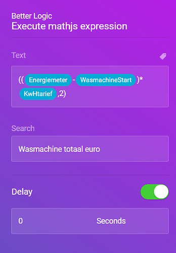

Hello, Most is working in this super flow!
one thing gives an error, i can use some help with this.
THX!!!
I think you meant:
round((Energiemeter-WachmachineStart)*KwHtarief,2)
Yes, now it works!
What does the “round” do?
THX!!!
round(1.2233,2) will round the number to 2 decimals. So it becomes 1.22 in this case. It is javascript programming. The round is the name of a function, which is a small piece of predefined code you can use when programming something.
