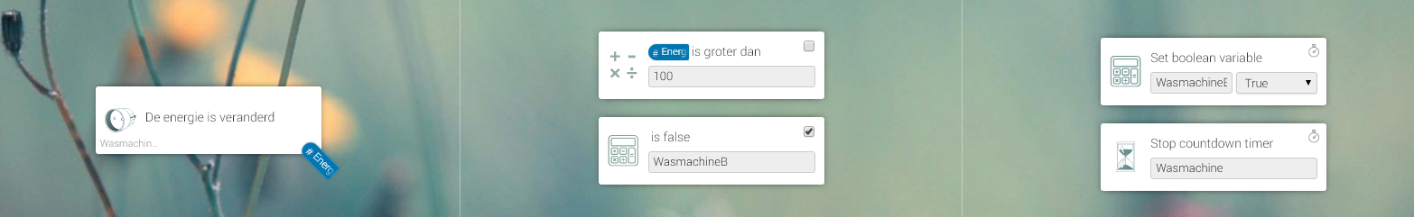

You have to add a check in the AND coloms:
Becomes:
When power changed
And ‘Power’ is greater then 80 AND variable WasmachineB=false
Then Set boolean variable ‘WasmachineB True’
Stop a timer ‘Wasmachine’

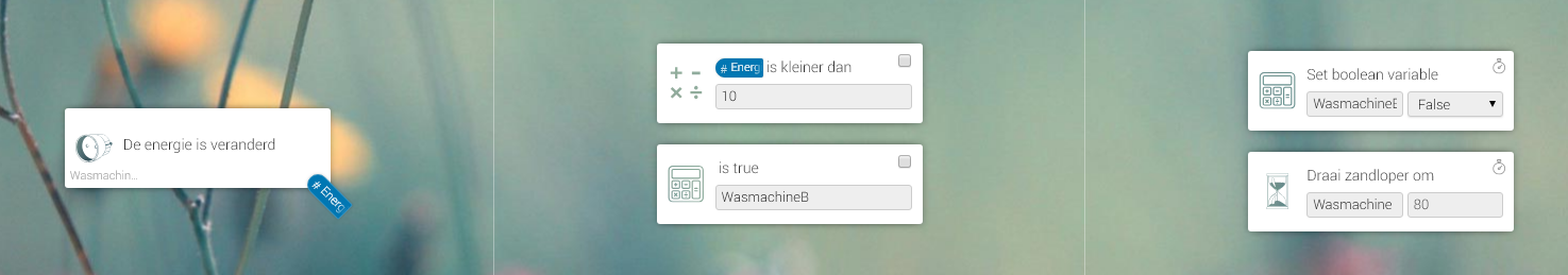

becomes:
When the power has changed
And ‘Power’ is less then 10 AND variable WasmachineB=true
Then Set boolean variable ‘WasmachineB False’
Start / update a timer ‘Wasmachine 80’
This to prevent the timer to run when power changed from 9 to 8 f.e. Or from 2 to 1.
