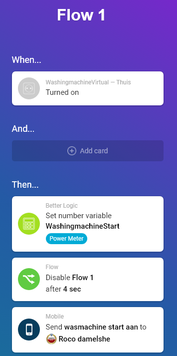

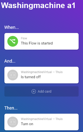

i made a virtual device. And in the first flow:
I start the 2nd flow:
Then i made 2 other flows.
So when power goes up, “Flow 1” is started, sending the notification and disabled after 4 seconds. This way u get the notification only 1 time. In "Flow2 " u enable “Flow 1” again.

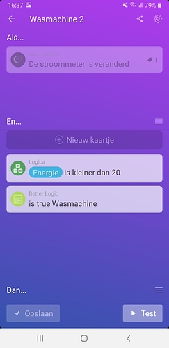

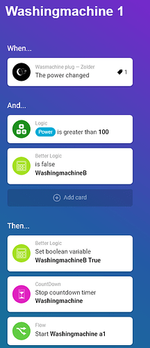

Hello there, with these flows, I get the notification 2 hours later. Can anybody check the flow?
Flow 1
Flow 2
Flow 3
Thanks!
I see “stroommeter is veranderd” and “energie is veranderd” . Ur sure u did not mix up something there?
@Rocodamelshekima would it be possible you make a rampup of the complete set of flows with energy use an cost included? THX!!!
@Rocodamelshekima, thanks dude… Sometimes I wonder why I don’t see those things myself. I ll test it later. I ll be gone for this weekend.
