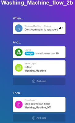

flow 2 triggers on any change below 10, so even if it changes 0.01W for a split second.
add a “timer is running” in the AND column, then it won’t reset the timer.

But isn’t that the wrong way around ?
When the problem occurs (so the timer is already running):
“Energie is smaller than 10”= TRUE
“Timer is running” = TRUE
Now al condition in the AND part are met…so now the Then part is triggered i think ?
Peter
woops it indeed needs to be “is not running” so the timer only gets set if it isn’t running yet. the flow would even never activate as it can never start counting :sweat_smile:
maybe also add the logic value for the washing machine, so it won’t trigger again if you turn off the washing machine completely

@Caseda fyi: It works fine now, thanks :wink:

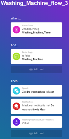

Is there a easy way to add another timer? that when the power usage is below 10 Watt for 30 seconds, start final part of the flow.
My problem now is that, It often alerts it’s finished, while it’s not. Because the power dipped below the set value.
You can use a second timer with another name (e.g. “Timer1” and “Timer2”), of course.
If…
The consumption has changed
And…
The consumption is below 10 W
Then…
Start Timer “Timer2” with 30 s
If…
Timer “Timer2” has expired
Then…
Whatever you want…
But there is also an other way.
If…
And…
Then…
Start Flow “Final Part” with 30 s delay
If…
This flow is startet…
Then…
Whatever you want…
But maybe you post your actual flows. Then it is much easier to give you hints.

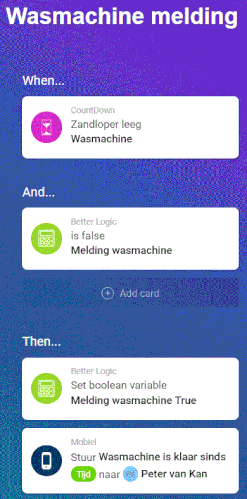

Oke, so if I understand correct it should be something like this:
And then I also have the cost flow from this thread, but that is working fine.
If this is the way, it does seem rather complicated. And makes me wonder if there is not a more efficient way of creating such flows. Because if I also want to have this for my (Dryer, Dishwasher etc.) I would have to create like 5-7 flows for each device.
Seems to me a large number of flows to maintain and keep track off.
What is the best/easiest way of checking your flows, to see how they work, what checks did they pass or fail. Some sort of logging to see what is happening if something is not working as intended.
Thanks!
You are using Stroommeter here and I think that must be Energie. That’s how it is in the first flow. I also use this with my washing machine and that works well.
Yeah that’s also possible, changed it now. Hard to see while building a flow what the difference between the two is, it was also working with the “Stroommeter”.
But still I would like to know if my second timer is correct. To filter out unwanted power (energy) drops, either because of the communication between the plug and Homey, or just cause the machine does not need any for a moment.
