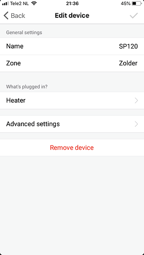

And maybe there is a setting for the plug in advanced settings to set the max?
I don’t have the plug meself but know other plugs have a setting like that.
In the app there is no such setting

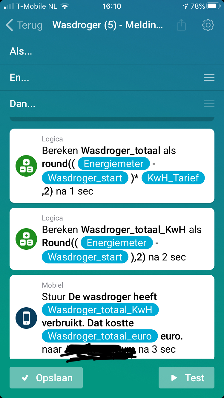

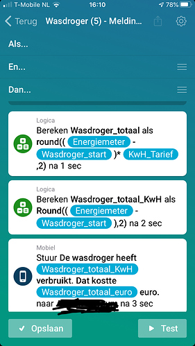

Hi all,
I could really use some help with this. I implemented Rocodamelsheki’s solution for my washing machine and it works perfectly. Then I made the same thing for my dryer but for some reason the calculations don’t work. I do get a notification when the dryer is ready, but I get a strange NaN message for the totals (see screenshot). I already checked for typo’s and spaces but it seems I am overlooking something here. For reference purposes, I also include a screendump of the relevant flow. Could someone please help me with this? Thanks a lot!
