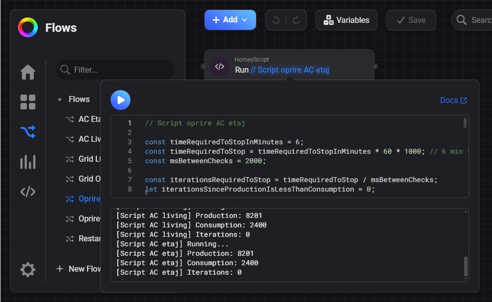

Below you have the code of script flow, that is made by my son. I don’t know programming codes…
// Script oprire AC etaj
const timeRequiredToStopInMinutes = 6;
const timeRequiredToStop = timeRequiredToStopInMinutes * 60 * 1000; // 6 min (in ms)
const msBetweenChecks = 2000;
const iterationsRequiredToStop = timeRequiredToStop / msBetweenChecks;
let iterationsSinceProductionIsLessThanConsumption = 0;
let minSeparator = '';
if (timeRequiredToStopInMinutes >= 20) {
  minSeparator = 'de ';
while (true) {
  const ac = await Homey.devices.getDevice({ id: '8955e5e5-83f9-4563-8a2d-1330c7a01eab' });
  const isAcOn = ac.capabilitiesObj['onoff'].value;
  console.log('[Script AC etaj] Running...');
  if (isAcOn) {
    const victron = await Homey.devices.getDevice({ id: 'ff6580a4-623e-4c5f-8e06-9ccf153d053c' });
    const production = victron.capabilitiesObj['measure_power.PV'].value;
    const consumption = victron.capabilitiesObj['measure_power'].value;
    if (production < consumption) {
      iterationsSinceProductionIsLessThanConsumption++;
    else {
    console.log('[Script AC etaj] Production:', production);
    console.log('[Script AC etaj] Consumption:', consumption);
    console.log('[Script AC etaj] Iterations:', iterationsSinceProductionIsLessThanConsumption);
    if (iterationsSinceProductionIsLessThanConsumption >= iterationsRequiredToStop) {
      await ac.setCapabilityValue('onoff', false);
      await Homey.flow.runFlowCardAction({
        args: {
          title: `Notificare din script`,
          text: `[AC Etaj] Oprit pentru că producția a fost mai mică decât consumul timp de ${timeRequiredToStopInMinutes} ${minSeparator}minute.`
      await wait(10000);
  await wait(msBetweenChecks);

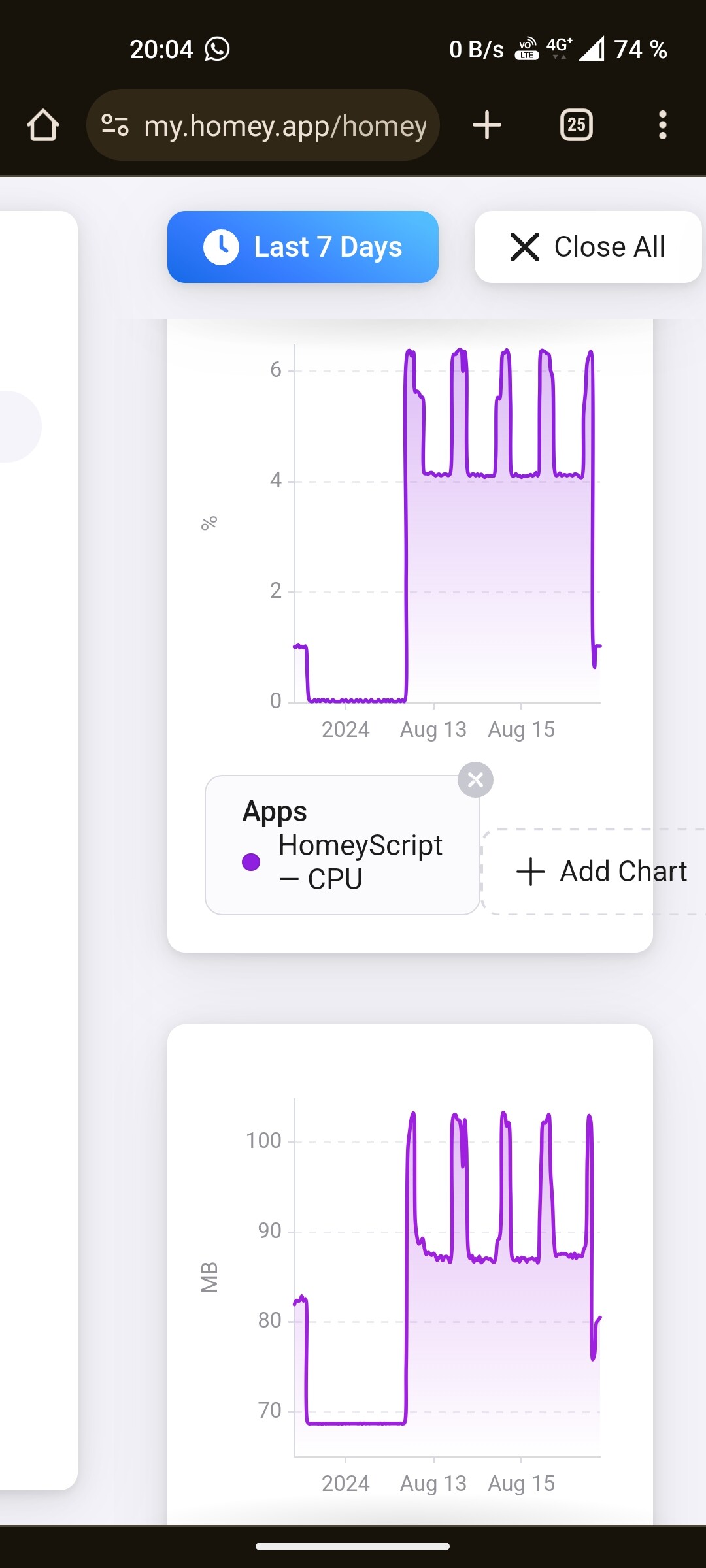

I’m curious about HS memory use.
Goto
https://my.homey.app/insights and enter homeyscript mem in the filter bar on top
