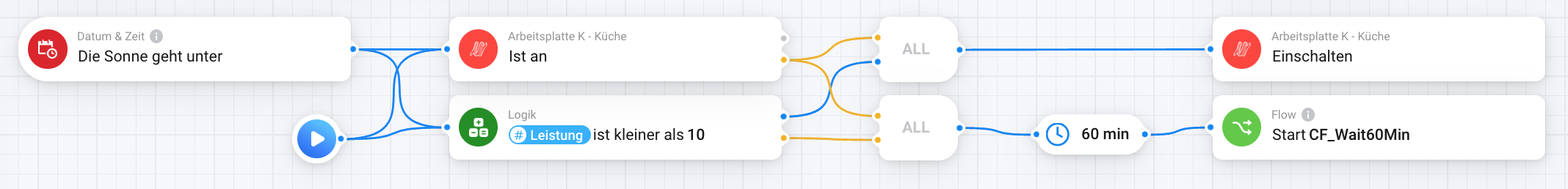

I am trying to set up a advanced flow to turn on my lights after sun set but only if the electrical price is below a certain limit. If its not, the I want the flow to try again in 60 minutes (when the electrical price might be lower). But I can’t figure this out in one flow.
Any smart ideas?
Either set the flow just every hour and check if its sundown (and let it trigger at sundown), or, you need* a timer App like Countdown or Chronograph and set a countdown/timer to one hour when the sun goes down. Every time the countdown triggeres, restart them if the sun is still down.
* I guess you could ofc just start a checkflow after a wait of one hour, but if homey restarts, this kind of delays do not work, so, when using more then a couple of minutes, i would suggest a Countdown/Timer app.
I think this is what you asked for:
But due to the already mentioned problem with the delay card, I would also prefer a timer app.
