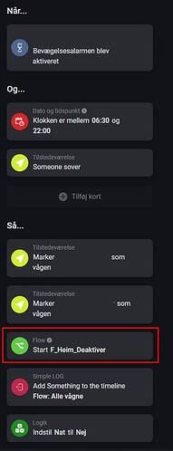

I have a issue, where I have created a flow, that excecute another flow.
Then, after some time, I changed the naming standard of my flows, and deleted a couple of flows.
Now I have a flow, that points to “F_Heim_Deaktiver”. But I have no flow with that name. I don’t even have a flow that excecute the stuff in that flow. So, the F_Heim_Deaktiver" works, but I don’t have it. (therefor I can’t see what configured, or changed something).
How is this possible, and How can I get it back so I can see what that flow does?

If you change the name of a flow, the name is only changed in the original flow. The name will not be updated in a flow card as that one you have highlighted.

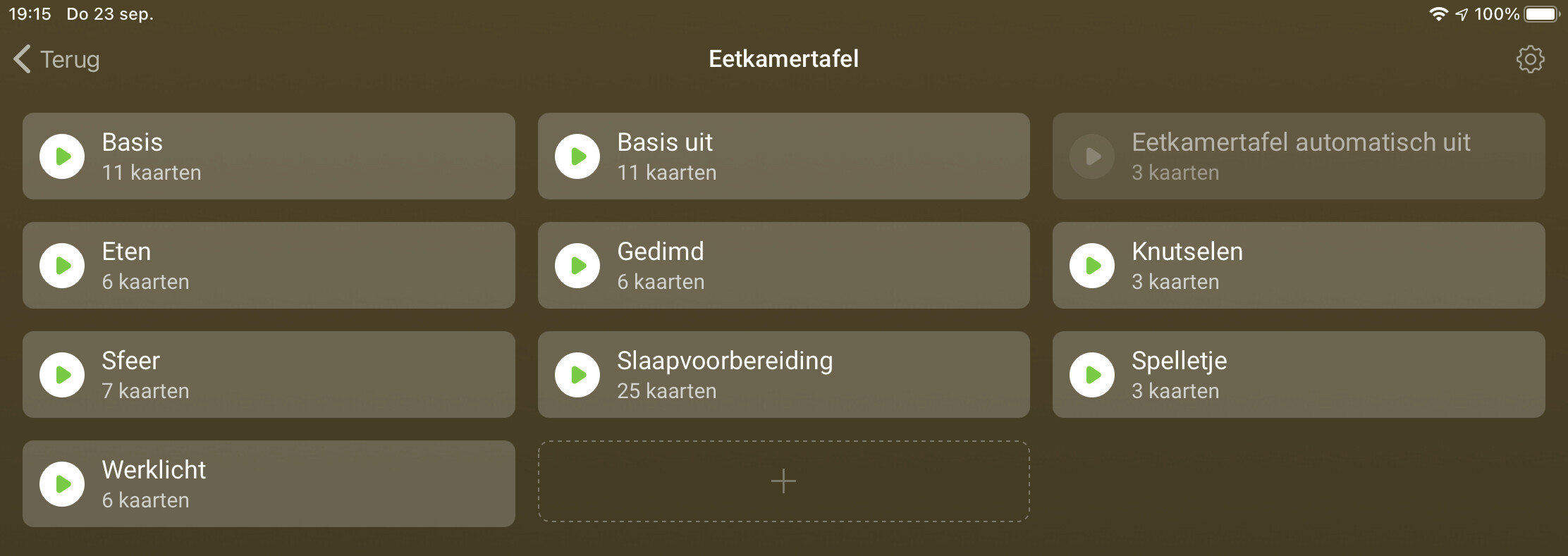

Maybe you can discover the flow by going to devices/device that is switched by this flow, there is a link to the flow(s) that are used for this device, you can see how the flow is named.

It is what @DirkG says; if a flow get’s renamed it doesn’t update the linked flows. It just updates the name of the actual flow. What you are seeing is a name pointing to an ID.

As @JPe4619 said, a flow does exist, just not by the old name. The best way to find it is through the devices it operates. Two ways: in the device page, go to the flows tab to see which flows are associated with that device and look through them.
