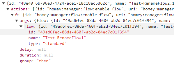

it still uses the UID but caches the Called Flow name in the calling Flow.
