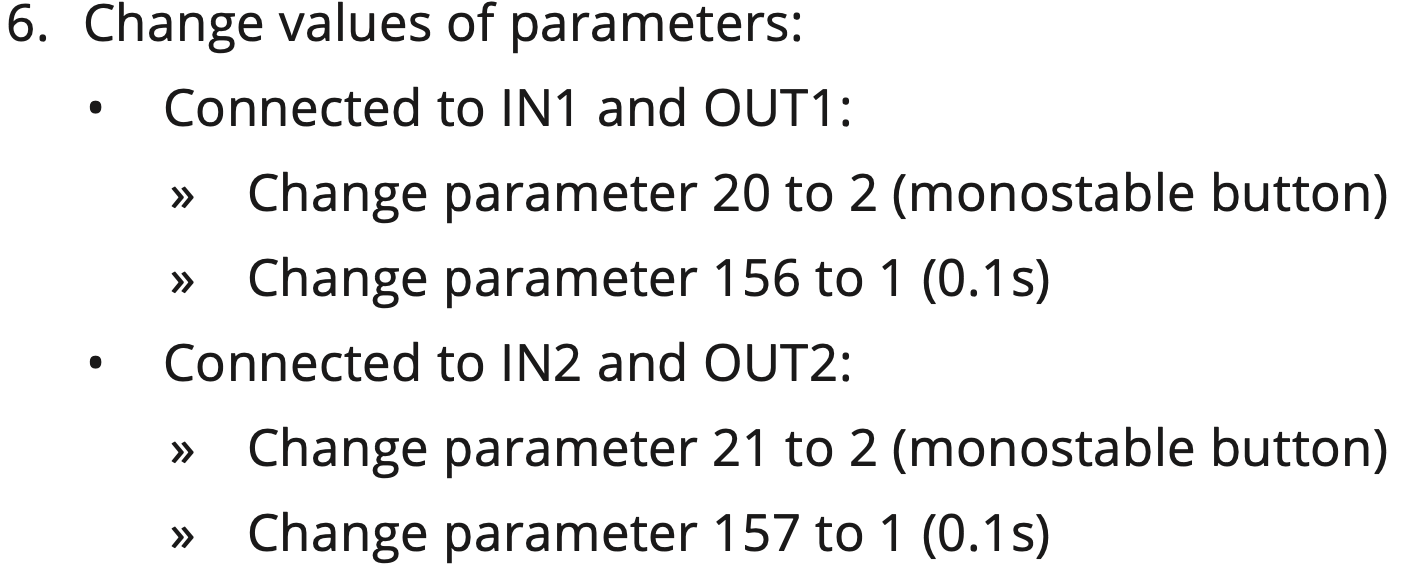

Indeed, for connection with gate/garage opener you need to change both parameters 20 and 156 (or 21 and 157 depending of what input/output you use)
Using the below values:

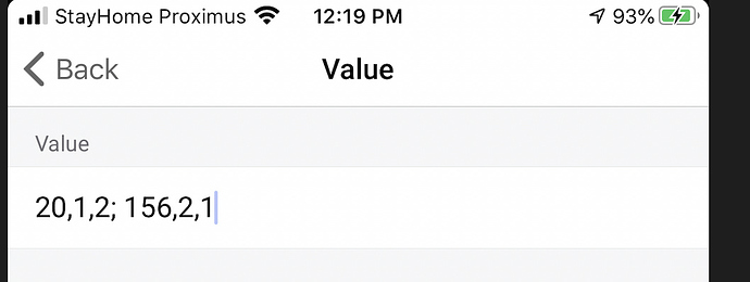

Under the Advanced settings of your Fibaro Implant and under “Raw Configuration Parameters” write the required data. In your case 20,1,2; 156,2,1
This is for Input1/Output1. Same for Input2/Output2 if you use this combination then just use 21 and 157.
Short explanation, 20 is Parameter, 1 is length (1byte) and 2 is the Value. All this from the Fibaro Manual.
Good luck and hope it helps.
P.S. After writing the above data don’t forget to click on the tick sign, top write corner :heavy_check_mark:

Hello. I am trying to input hte raw parameters but for some reason, I only have the Back button after pasting these parameters. After pushing on BACK The “Check” sign is off!
Any suggestion?
That’s perhaps because you’ve already written those parameters before.
Try for example invert them and write them manually rather than copy/paste. Like have 156,2,1; 20,1,2
I tried it manually as well. It just cannot sunlit them.
Don’t use spaces in between the two items.
Thanks. That works
