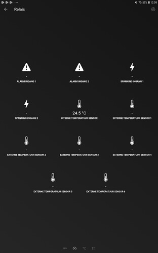

I was inspred by this thread and started to add a smartimplant on my garagedoor as well. Now im testing it with a 16vDC adapter i had lying arround close to homey as a test. I can control the implant via homey, but the inputs wont react to my magnetswitch or photovoltaic sensor.
I tested with my voltmeter and when i place my relector or magnet, input 1 or 2 receive 16v. The input in the homeyscreen stay -
Is there a minimumvoltage to activate?
