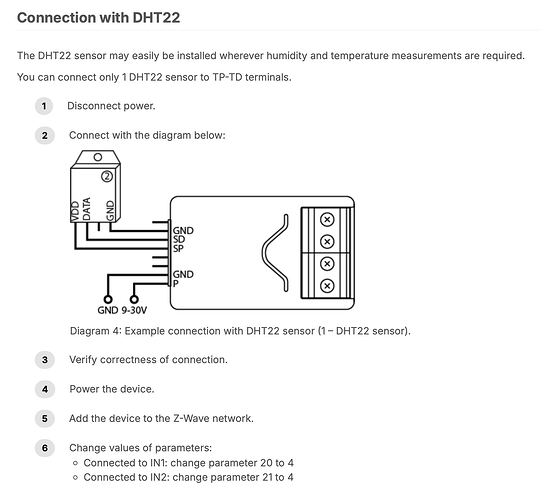

Please note that it is important to connect the DHT22 sensor first, and then to include the Smart Implant:
Thanks. It took almost a day but then it started to work.
