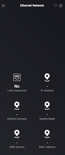

How do you conclude there’s no Ethernet connection?
I also have another box (eedomus) which sole purpose is to monitor my main IP devices and reboot whatever is needed
Capture d'écran 2024-12-29 130831
