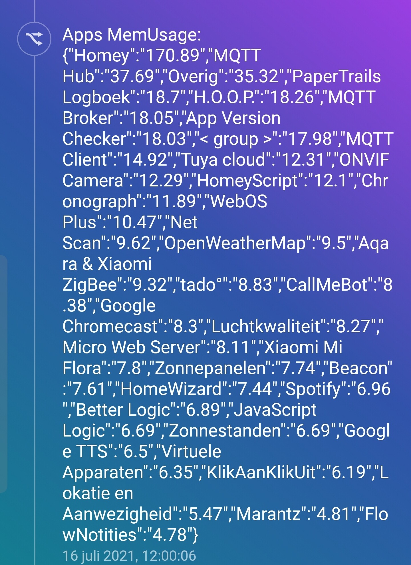

I only experience the offline issue when the memory really runs out.
In Insights you can track the memory usage of ‘ever growing’ apps. Then you can decide to remove those, or schedule an app restart every x hrs, so it’s memory use is ‘back to normal’ for the time being.
In my case it’s an “app too much” most of the time.

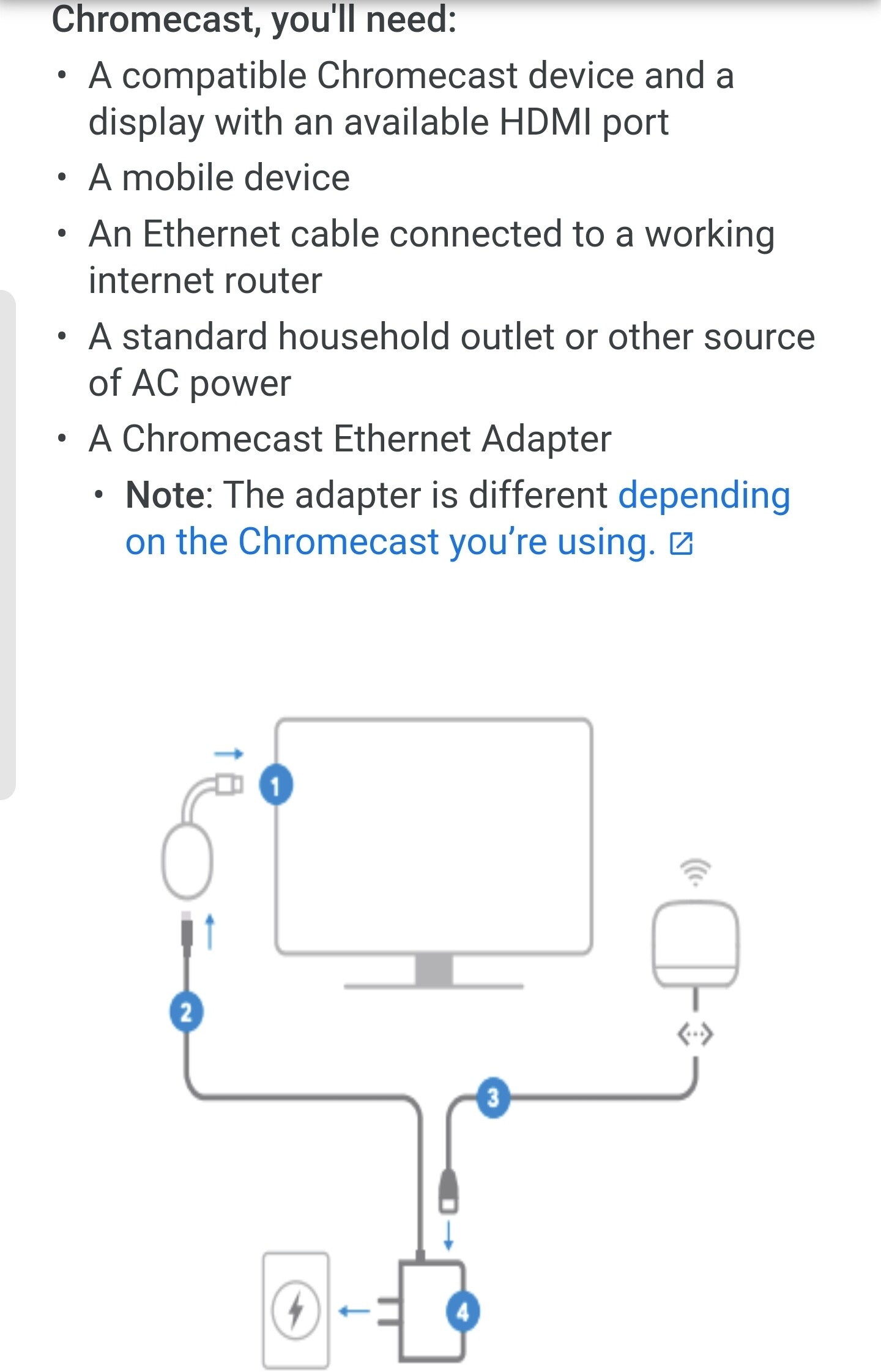

Device is usb powered, the ethernet connection is located in the power adapter.
I have done that with an y-cable.
My report once in the aatp channel that Homey did not correctly restart was answered by Athom with the question to remove the usb2ethernet cable that showed up in the bootlog.
But imho different drivers, cables, possibly instable power supply (even due to questionable cables) and support for a multihomed Homey probably was enough not to implement the driver although openly discussed as a hacky Friday option.
I use my chromecast in this way, with this Y cable with built in LAN adapter, and it work 100% perfectly stable on a chromecast.
Using this adapter with a micro usb to mini usb adapter like this would really be a solution imho Micro USB to Mini USB Adapter F/M - Micro USB Cables | Belgium
only the homey firmware need to support it, and if read correctly here it doesn’t ?
