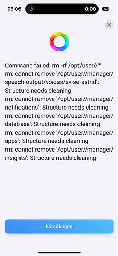

yesterday my Homey pro 2016-2019 stopped working. It disconected from the network and now i cant reconnect it. When i try i get the same error-message every time.

“Structure needs cleaning” is indicative of file system corruption.
Yeah. Due to storage degrading most probably?
Yes, eMMC will start failing at some point (and when it does, there’s not much more that you can do other than replace it, which is going to be a challenge/impossible with the older Homeys).
