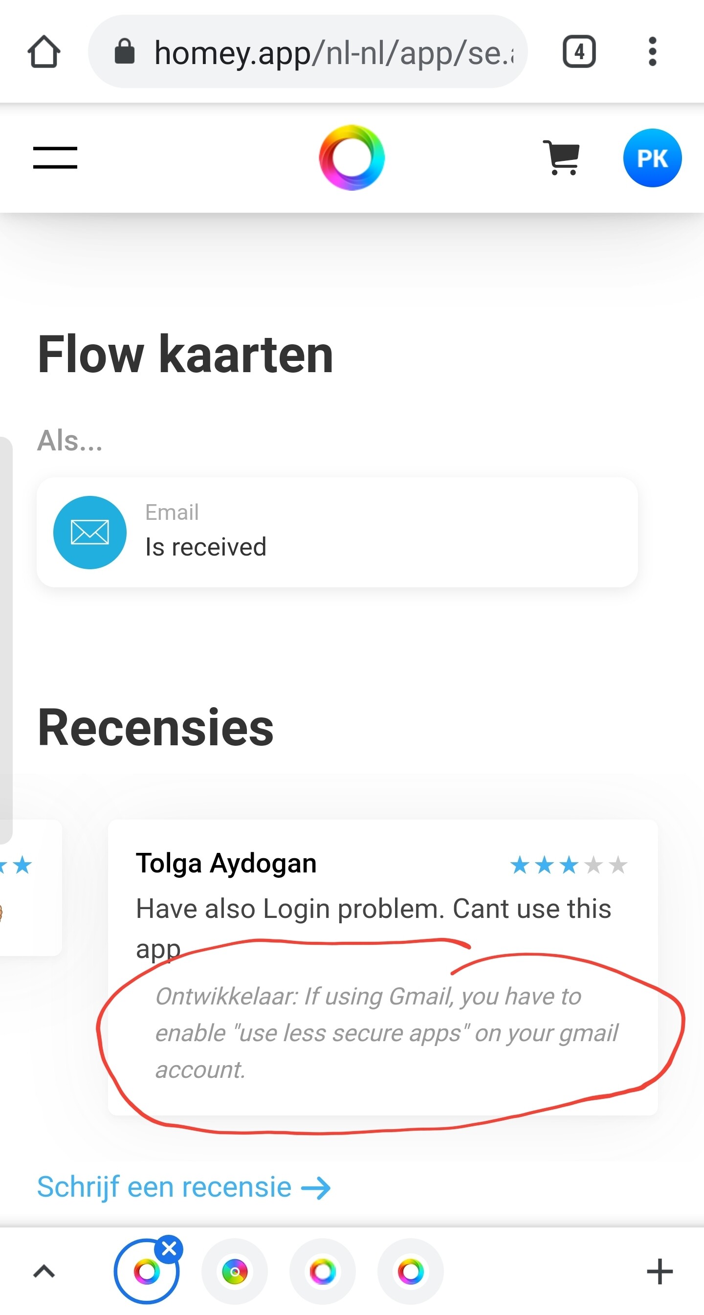

Could this help you out? The Gmail account setting?
All of a sudden it seems to work now. Didn’t change a thing. Hope it keeps working.
The setting “use less secure apps” is not available when 2fa is on…

Is it not possible anymore as Google no longer supports less secure apps ??
It should work with Gmail when you sign in with app passwords: https://support.google.com/accounts/answer/18

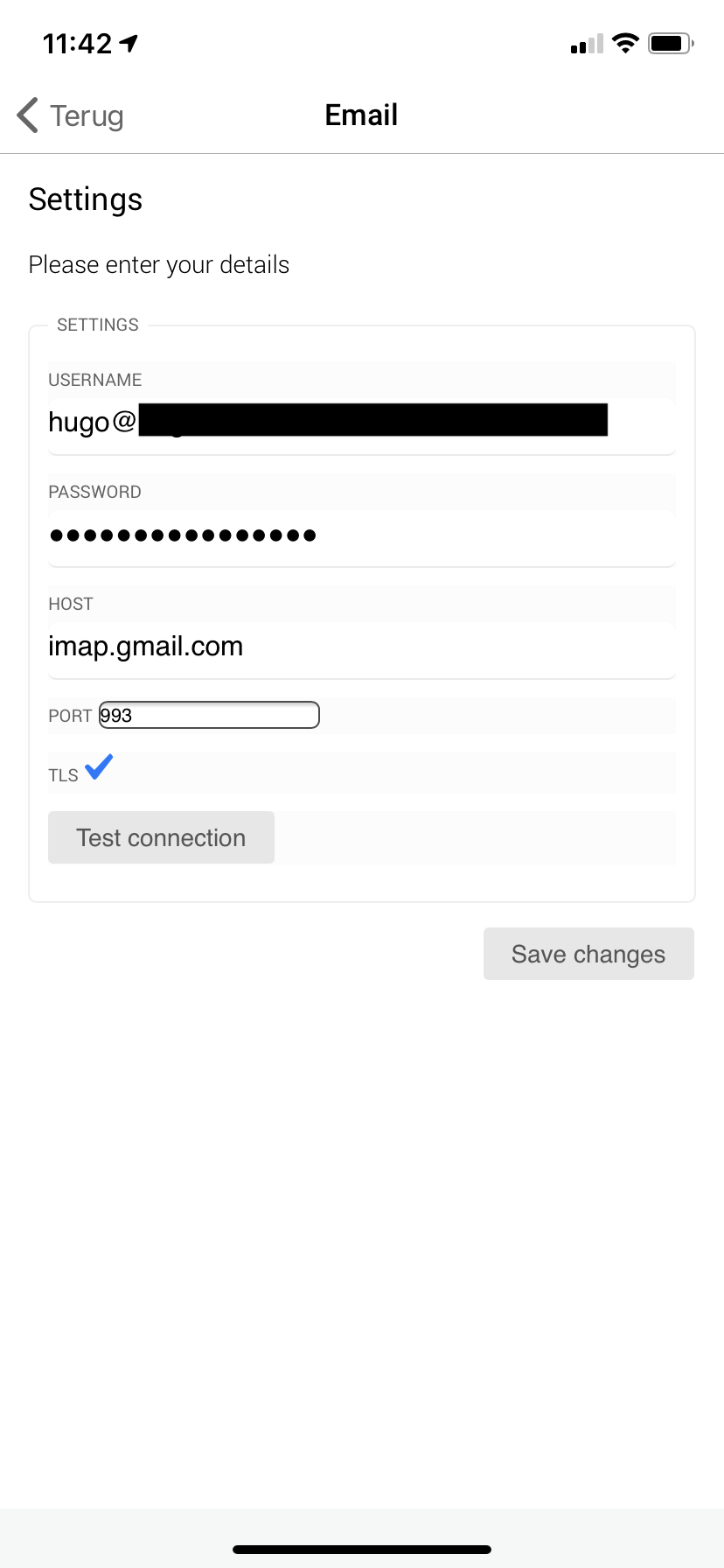

I can not get the app to work. The problem is that the flow does not start/detect incomming mail. The rest works…
What could be wrong when it does not detect the incomming email?
Are your settings correct in the email app?
Does ‘Test connection’ work in the email app?

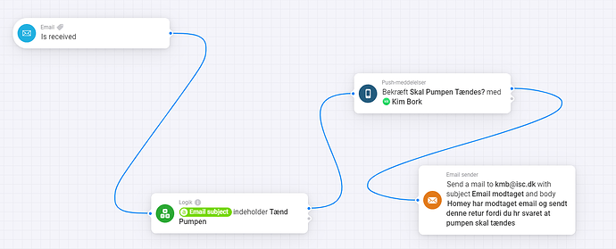

And / also, first try without the logics conditional card. OR add a timeline card to the yellow nipple (= false; blue nipple = true) to see if the condition is not met
Yes- It workes - no error
