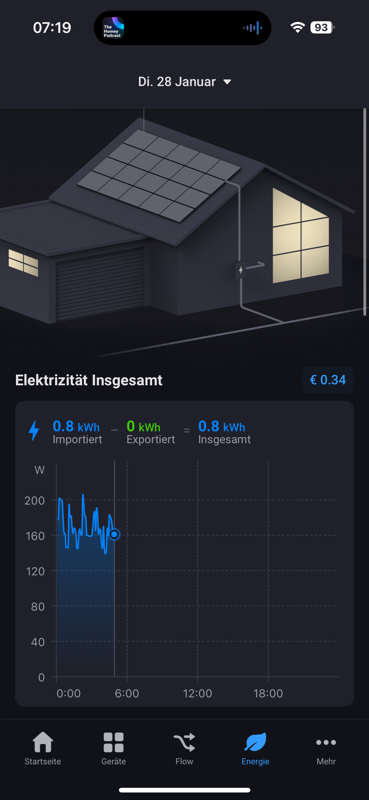

I am using the frient optical meter, worked for a couple of weeks. But last week it just disappeared in the energy tab. What happened?
Only my solar panels are shown.
To be precise: it stopped working on 28th of January. At 4:55
And? Does it still work as device in general, or doesn’t it?
Did anything get (autom.) updated around that time?

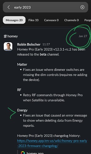

It might be related to this update, if you had the experimental updates setting enabled?
Yes device is working as usual outside of the energy tab.
Yes I believe this update has broken my meter, I may try to delete it tomorrow.
