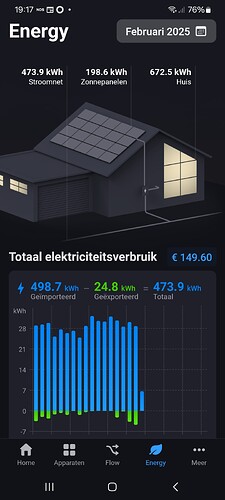

@Doekse, what changed on the 18th of February.
Since that date my Youless does not report kWh anymore. It says that the device only reports realtime energy usage.
When you have firmware updates on auto update, and you don’t allow beta updates, this Feb. 17th update can be a candidate cause:
The last Youless app update was Dec. 7, 2024 btw.

My Youless LS120P1 only reported kW in the Homey Energy app.
I upgraded to Youless app 4.5.1 and had to reinstall the Youless LS120P1 to get the right names for the capabilities. Now also kWh is shown.

I’m not really fond of this solution. I have some PBTH devices based on the Youless and besides that, best some flows with interaction with energy.
It will break all these flows and PBTH devices
I don’t now any other solution.
PBTH devices can be repaired without any data loss if you repair the PBTH device within minutes.
And there is a script to repair flows after repairing a device.
Well, i did do it. Removed the P1.
After re-installing it appeared coreect in the energy tab. Also repairing PBTH devices was easy and did the trick.
Spend some time on reparing my flows, scripting is not my thing, now everything is ok again.
Thanks a lot, I would not have thought on this solution
