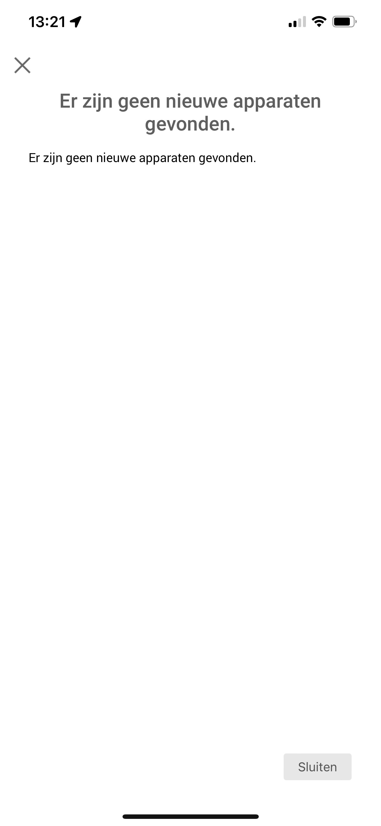

I received my VOCOlinc Diffuser, but I cannot add it to Homey.
  • I first connected the device to HomeKit. That worked.
  • I tried adding it to Homey, through the HomeKit controller: no devices.
  • I removed the device from HomeKit.
  • I tried adding it to Homey, but no devices. Not as Air Purifier, Humidifier or Light.
What am I doing wrong?

Same problem. I have 4 Vocolinc humidifiers and cant they connect via homeykit: " no devices."
@robertklep, can you fix it? Can a donation help with this? I am ready for to do it :wink:.
With homeassistant they work nicely, but now i have home assistant only for humidifiers.

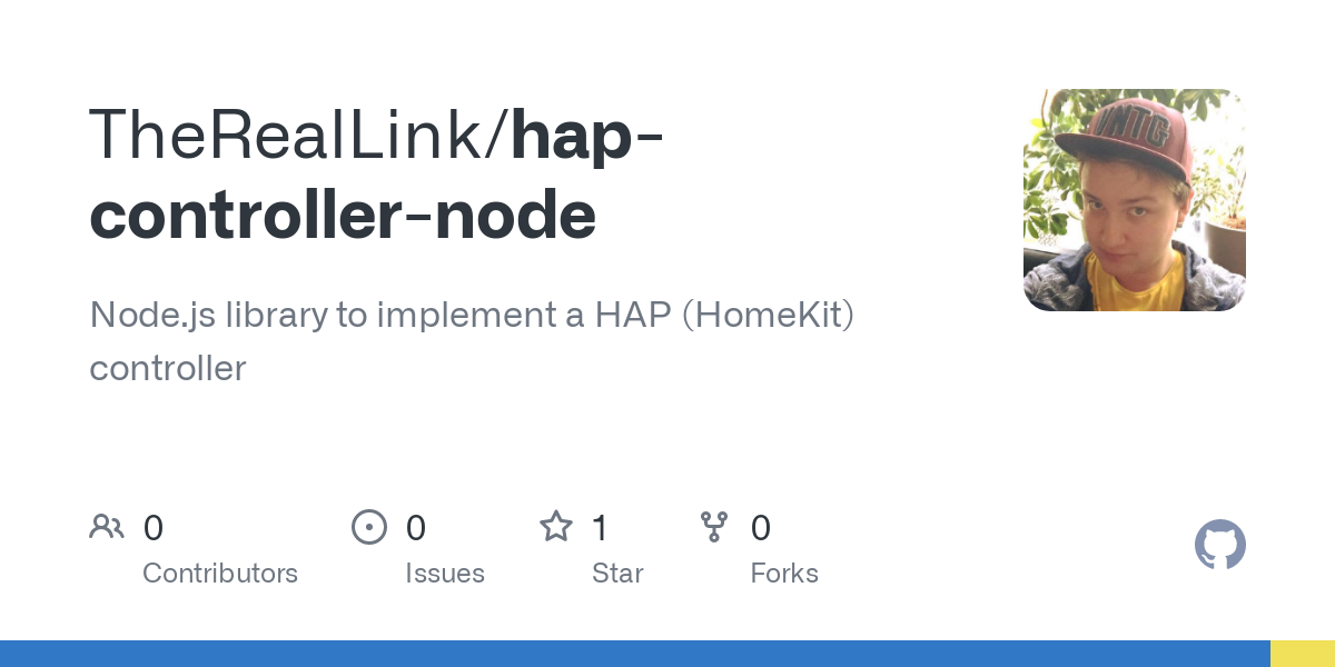

I was only able to find this by googling
not sure if it can help
