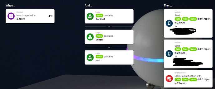

Isn’t there a trigger based on “A device has become unavailable”?
Almost. Under Devices, there’s a trigger if a device hasn’t reported in a certain time (maximum 24 hours).
You can then sort out certain devices by making a Logic under the AND-section.
https://homey.app/f/dKsuJ_
This is not very usefull
With this flow
I get this result
So when I dont use a door or a window for a day I get a notification that the sensor is not working
(Yes I know the flow is now for 2 hours)
Not triggering is not the same as “not responding”. Most battery powered devices have a default wake-up interval set to report regularly to the controller. So “not responding” should only be caused by an empty battery or loss of signal due to range or interference or something like that.

Pick a logic card in the AND colom.
