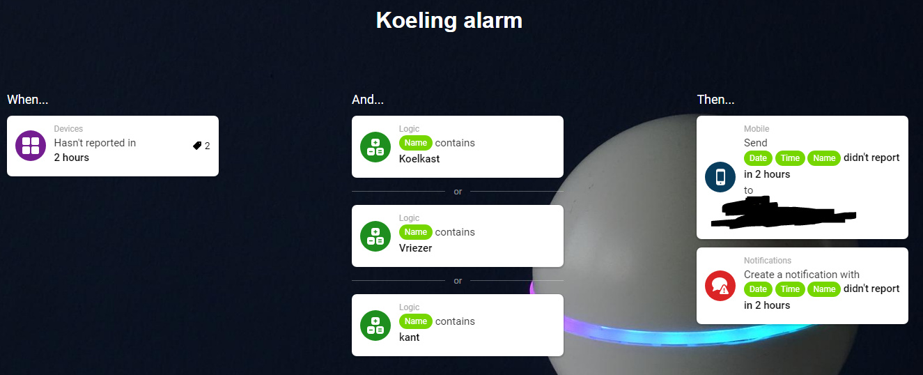

How would Homey be able to know if a sensor works when a window or door gets opened without actually opening the window or door?
Not if you don’t have a robot that will open all doors etc for you and is connected to Homey.
But serious, if they are battery powered and you are afraid the battery is dead, u can use the “Device hasn’t reported in” card in a flow.
Requires devices to have the report function enabled (and in between the interval you set) of course.
Well maybe there is a way for homey to see if it’s still reachable? Don’t know if that’s possible
I you see it’s simple when you know it
. Thanks for the answer I am going to experiment with this
