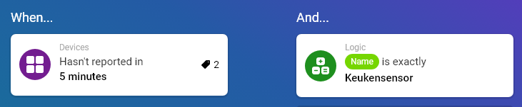

I tried to make a flow with your idea.
Example:
If: One device did not report for x time
And: Sensor is off in kitchen
Then: Telegram me, kitchen sensor did not report.
I started with the lowest option in time and tried all the options till 24 hours.
This morning I got 8 the same messages about four different sensors at the same time.
Since I set these flows I got already 13 different messages.
How? Is my flow completely wrong? Or is there something wrong with Athom?

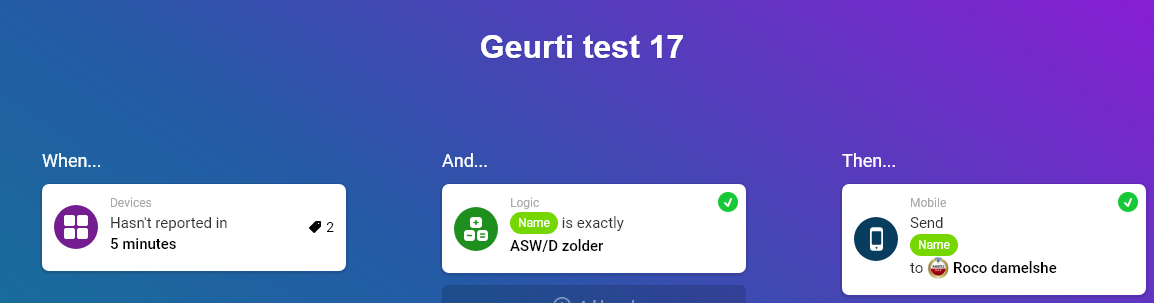

Try this:
Tag comes from the first card. If u don’t know how to use tags then look here.
This flow didn’t work and I got an error when tested

Then u have an error in the device name while testing?
I copied the name, to be sure not making a mistake.
Also checked for space error.
Well, it’s working here so maybe double check?
I tried both options, Zone and Name
Zone I named keuken
And Name I named ASW/D keuken
Both are not working.
Heb ik weer :rofl:
And ur device is actually named “ASW/D keuken” ?
For sure :blush:
Try testing with a name that doesn’t contain a / character.
Just tested with a name that does contain the slash and that also works here.
