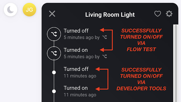

Just to reiterate, I am able to successfully communicate with the device. I turned the device on/off via Developer Tools to ensure Z-Wave nodes were routed successfully. Additionally, I turned the light on/off via the Test function of the flow(s) in the Homey web app. This is reflected in the history/timeline of the device:
So communication to the device is working properly. However, the saved flow isn’t automating/triggering/outputting to the device. These simple standard Date/Time flows to this device were working until just recently (late July 2026). Also worth noting, this is only happening with flows/devices associated with my Homey Bridge. Other Date & Time flows are executing properly with my Homey Pro Mini and WiFi devices. I’m also currently running Homey version 13.4.0.
