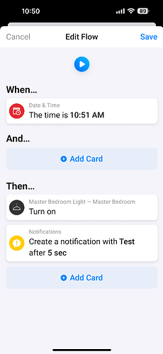

Here is a screenshot of the simple flow I set up for testing:
You still have to choose which light.
You can select whether only one lamp or an entire zone should be switched off.
Maybe this will you help also:
https://support.homey.app/hc/en-us
I believe that I have selected the device, but as a newbie I could be mistaken. When I write the card to turn off the light, I first select the device - in this case the master bedroom light - and then I select turn off. The flow will work occasionally - but 90% of the time it does not.
In the flow you showed I think you selected the ‘Zone’ bedroom, not a light ..
Thanks Johan - you’re correct. In my haste to share a flow, I selected the “Master Bedroom” zone instead of the “Master Bedroom Light”. Sorry for the confusion. Here is what my flows look like more typically - and they don’t work. For some reason, it appears that the request to turn the light on or off is timing out before the light switches.
