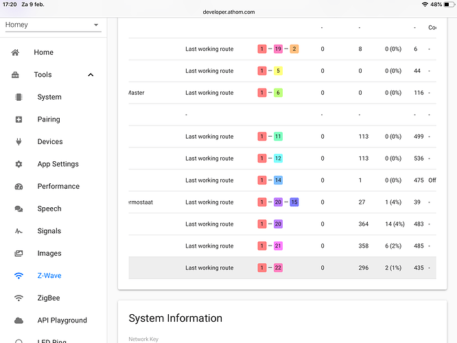

Can you take a look at https://developer.athom.com/tools/zwave and see how the zwave mesh is build up?
Attached a screen shot. As you van see there are Some transmission error.
20, 21 and 22 are the fibaro dimmers.

You can’t reset the error counter. Looks like everything is connected directly to Homey ( except 2, 15). That could possibly be the cause since the range of homey isn’t that great itself and how larger the distance the more you will have problems with interference and such.
What you could do is pressing the two dots right from the device in that overview and select Heal. This way you force that device to find a new route. Note: This works only for powered ( non battery ).
To add to that, start healing with devices which are near to Homey and work your way outside. As for the battery-devices, they can also be healed (IIRC) but they have to be woken up before pressing heal…
