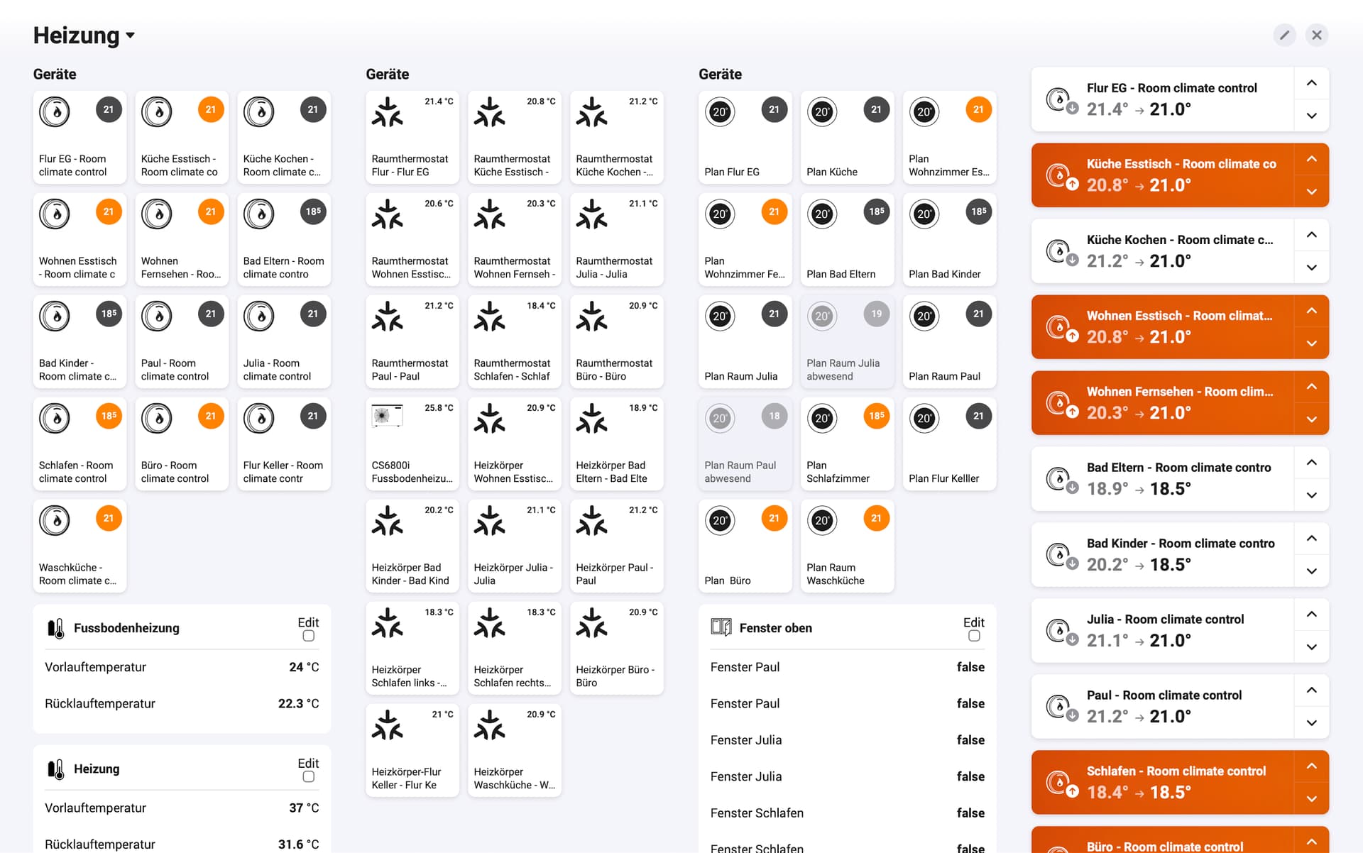

It is working well with the recent software versions. I have about 10 Room Themostat II and 12 Heating Thermostat installed via Matter and the Bosch SHCII controller. All is configured via Heating Schedulder and it is working well.
