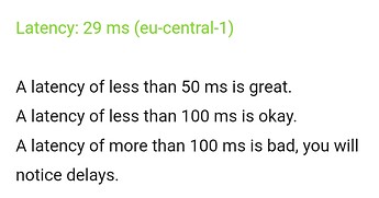

What does your measured latency say?
Here it’s around 50ms atm
Find it here:
29 seconds, but then again, Iive in Athom’s hometown… :slight_smile: (which is no guarantee, I know)
Milliseconds I think😬
Hehe, the servers are in Frankfurt afaik, but you’re closer anyhow then.
I’m on a 100Mbit ADSL so I think a latency around 50ms is pretty realistic :smiley:
Latency: 22 ms (eu-central-1). Middle of Netherlands, 500 Mb/s glasfibre. THIS bit of the Homey Bridge works excellently already for five months, since I have it. But the Fibaro not working, and just now the Coprocessor Not Connected message is not excellent.
