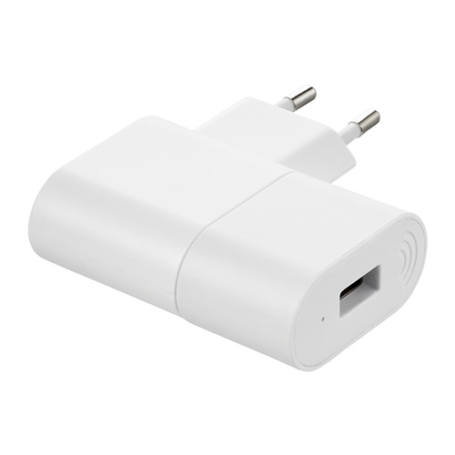

Wall plug
Repeater and usb charger
@Sjalabert I have one of those to.
@Kyrcio Do these already work with Homey?
Wallplugs work fine and extend the network
And the repeater has not arrived yet (at least not where I live), but they shouldn’t need driver support to just extend the network (aside from a prettier icon I suppose).
