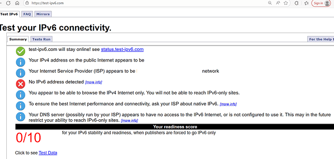

In regards to IPv6, i’ve already got this disabled on the router. This is what i get after trying the link from Dijker below.
Any other suggestions?
Thanks for that test link. The only issue is that IPv6 is unavailable as its disabled. So i assume completely rules out the IPv6 bug?

Correct. I’ve also a 0/10 result, IPv6 is disabled here as well.
