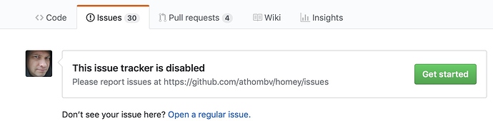

Could you file a request at https://github.com/athombv/com.fibaro/issues including the last picture?
Looks like I can’t:
This repo “https://github.com/athombv/homey/issues” is readonly so I also can’t add something.
