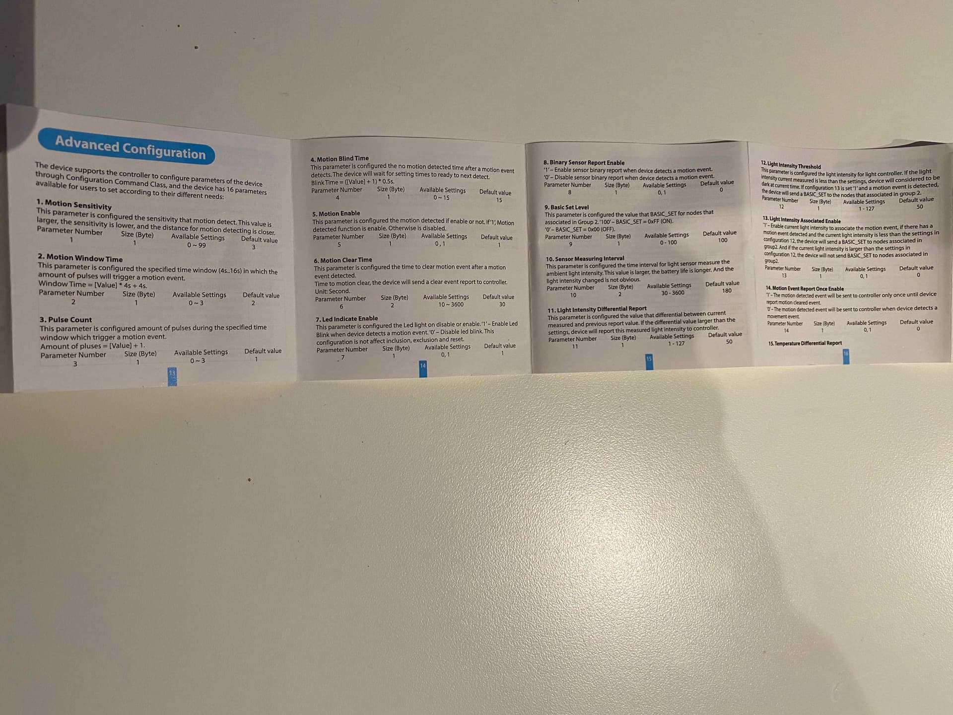

this delay makes them useless for me. I think there must be some problem with the settings? The paper documentation in the package has other parameters than the app has for our v2! Maybe the new settings have new parameters?
This is how the paper manual that I got looks like. How does yours look, @Niels_Veldman . the parameters here do not match with the parameters specified in the app for NAS-PD02ZE. Maybe that is the problem?
@markusv I think it’s a NAS-PD01 but the NAS-PD01ZE also does not match in terms of parameters.
I have added a new device under drivers (Github code from Marco Ruiter) and changed the device.js and drivers.compose.json and driver.settings.compose.json to the parameters on the paper, but motion still takes 5 seconds to respond.
I am not a developer, so this was my only option to try.
Or maybe there’s someone who can point my in the right direction.
