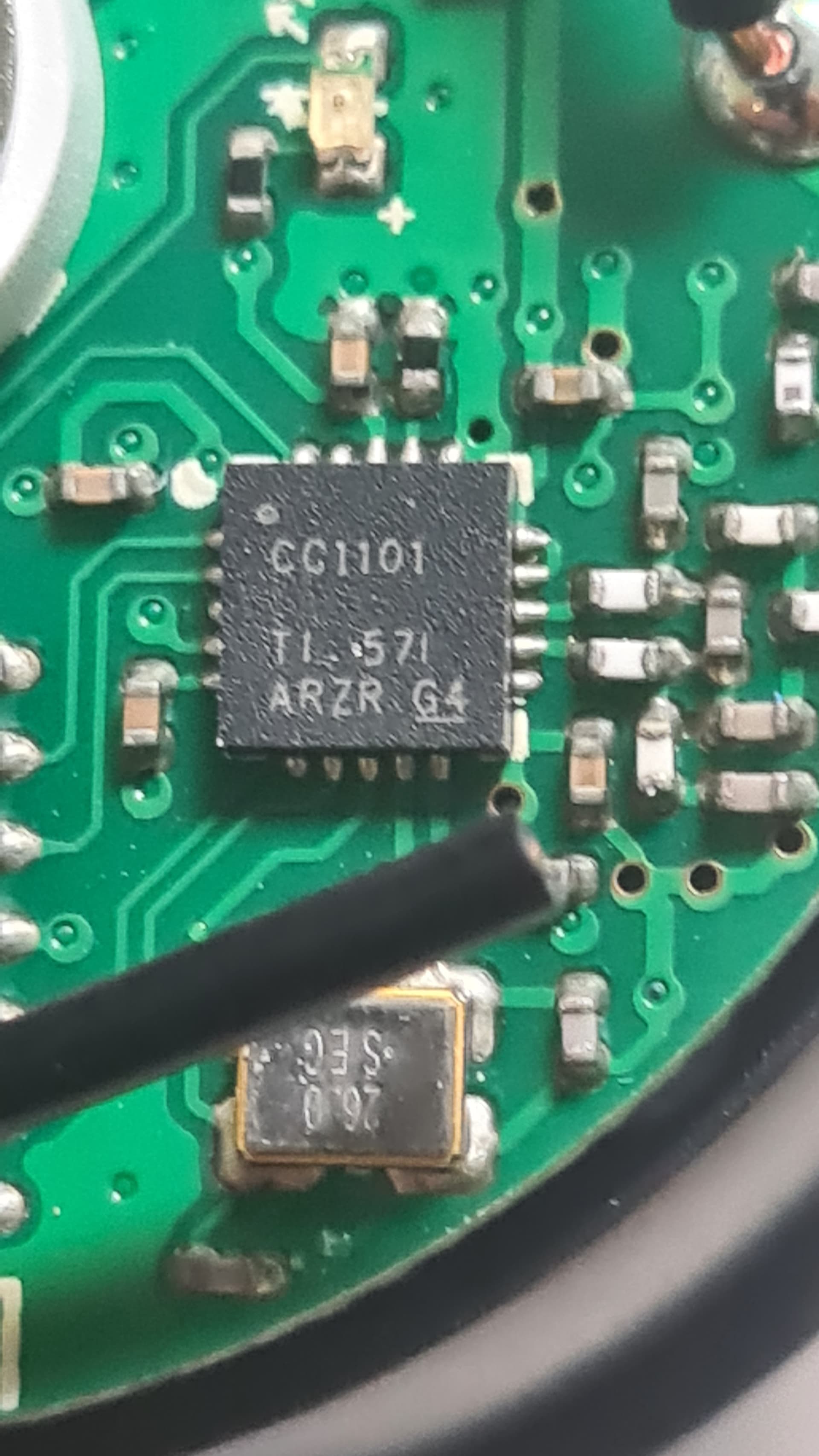

To add to it: I have opened one and noticed this.
The fourth on the far right is the one that is working. The box is just the box used to send them to me.

Related to the computer chip CC1101. I’m not an electronics engineer, but a Google search for cc1101 gave the following result:
Texas Instruments CC1101 data sheet
Extraction:
So it seems to be a Z-Wave motion sensor. But it is possible that:
  1. the sensors are broken
  2. these are sensors with a frequency of 915 MHz, which is only used in the USA, Israel and Mexico.

I googled it too. And I assumed this meant it is no WiFi. Because then it would have been a chip supporting 2.4GHz. Come to think of it: is it is Zigbee it is also in the 2.4Ghz range, right?
In your conclusion I think I am leaning towards the second option. It would be weird to have 3 out of 4 behave and look different that happen to be broken all three.
Would there be any way to determine if this is a 915Mhz variant?
Right, Zigbee is also 2.4 GHz.
Due to the data sheet and the different design I don’t think that they are Zigbee sensors, but you can just try to pair them as Zigbee device:
