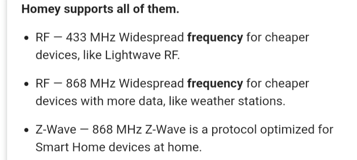

I bought a Neo coolcam pir and i can’t include or exclude it. The seller has told me as i am in Australia the 868 frequency wont work.
I thought homey worked with all frequencies. One of the reasons i bought it.

In ur developer tools u can find the hardware region for ur Homey. Mine is saying:
which has according the link Roy just gave 868.4 MHz, 869.85 MHz
Yours is possibly:
So there u can see the 868 is not gonna work on ur Homey like the seller stated:
Indeed homey works with all frequencies. But the frequencies it uses are depending on allowed frequencies in your country. Don’t know if RF 868 is allowed or used there, but Z-wave in Australia is definitely not 868Mhz.
Shouldn’t be a problem though, as long as you buy Z-wave devices for the frequency your Homey supports. But that may be illegal in your country if the used frequency isn’t allowed.
