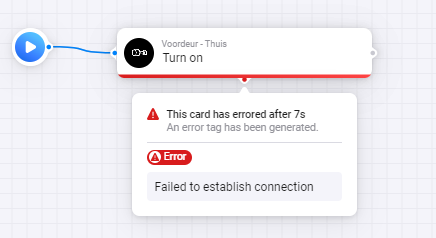

Good to know, but that does not explain why I’m not able to control the Bold Locks via Homey. It keeps saying unable to establish connection. Eventhough I was able to add these succesfully in the Homey Devices.
Any thoughts? I did see multiple topics on this same issue, but no solution.
Update: Also tried to activate via a flow via the web app, just rule out any mobile app related issues.
Same problem (See screenshot).
