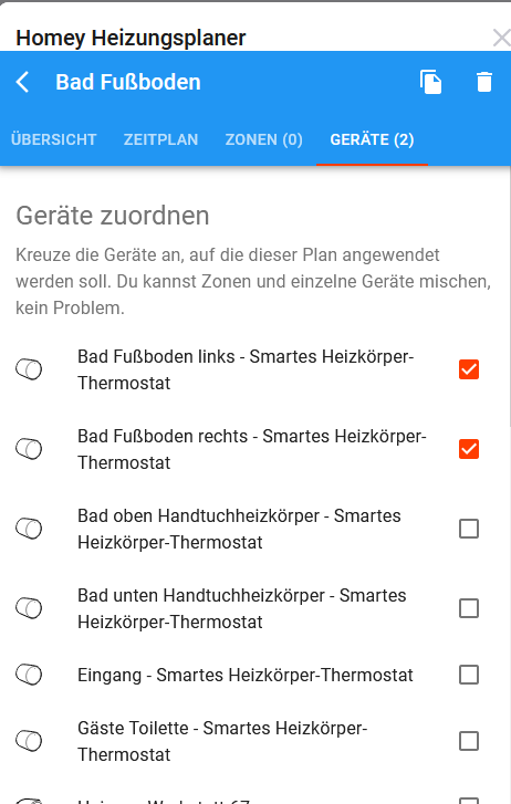

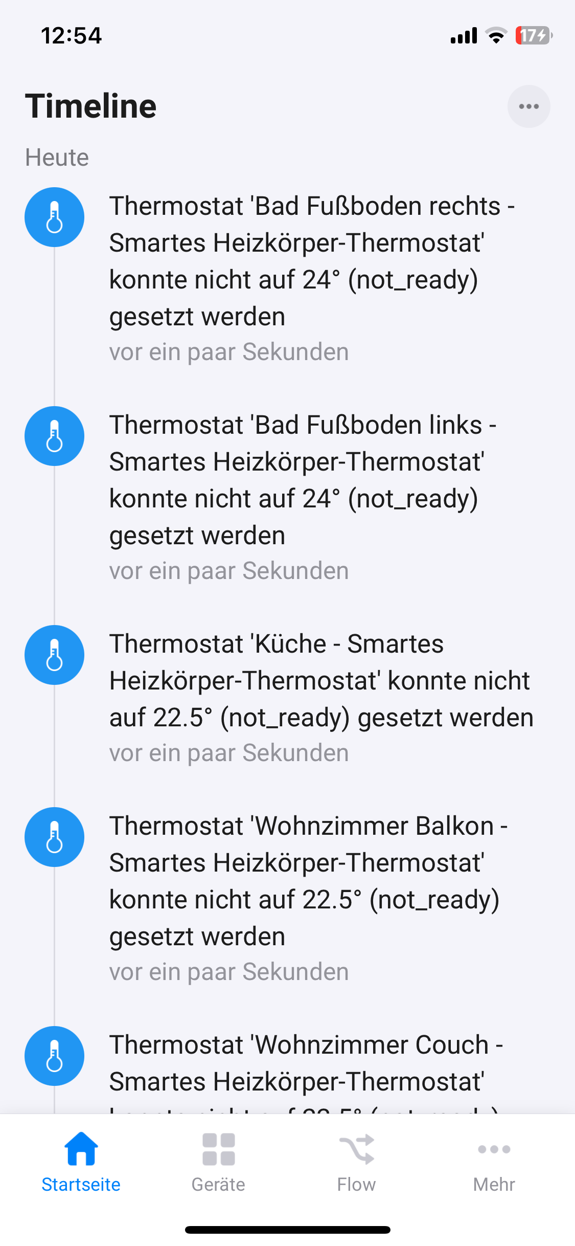

Hello everyone, since yesterday I have been getting the following error message with my heating plan: none of my heating devices can be set in the group… could not be set. (not_ready) If I manually control the thermostat via Homey, everything works. - I’ve already restarted the network, homey and the Tado Bridge and Shelly. What could be the problem? How can I solve the problem?

Then the issue most likely should be with the Heizungsplaner app.
Please post your issue in that topic.

The timeline errors are not from tado nor Shelly most probably?
In tuis case, the Heizungsplaner-App tries to set the target temperature of your thermostats. But the thermostats are not ready.
If only one has an error, the. it’s noch reachable.
If all have an error, then in most cases the thermostat app is not running.
Perhaps stopped - or more likely - it happened on Homey restart and the Heizungsplaner-App started before the thermostat apps.
